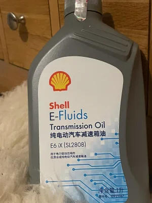

Service done today and by the way I asked them to check the reduction gearbox oil just for my peace of mind as I've read some posts here about some cars being delivered with too little in. The amount was ok but they were shocked at the state of the oil after only 11,000 miles. Lots of metal particles. So I recommend anyone getting a service of any age who hasn't had the oil changed, ask them to check it. 1/2 hrs labour to drain and put back if there's nothing wrong but well worth doing if there is.
Must admit - I've read this a few times before - I have the oil?? (can anyone agree with this), and will do mine at 31K eek😲 in the next few days and report the results.
