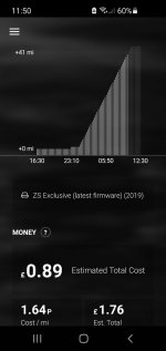

89p for an overnight charge: +41 miles, @ 1.64p per mile.

This was last nights charge now that we are finally on the Go tariff, with the Ohme charger.
89p overnight charge +41 miles, @ 1.64p per mile.
Am I reading that right?
If so that seems pretty good value doesn't it. That's a lot less than last month while we were still on their Flexible Tariff.

That doesn't look quite right.
Your chart slope should start at 00.30 and flatten at 04.30. your like like it was charging during late morning?
Yes, it doesn't turn itself off on the Ohme charger at 04.30 - just keeps going till we unplug it.
Do I have to set it up manually to do that, and on the minimum charge of 13p per hour Octopus Go, would that even charge it up?
Or do you not have the max charge cost switched off and just leave it to go full pelt for the 4 hours at night?
