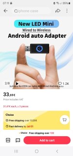

I had the same problem so l bought a USB android auto adapter ( no cable needed) and no problems since.
