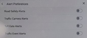

I ended up disabling the warning/hazard alerts for the built-in sat nav as I believe these are the cause, and it hasn't happened to me since. Seems to be bug (i.e. not returning to previous audio level after it has alerted).

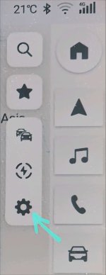

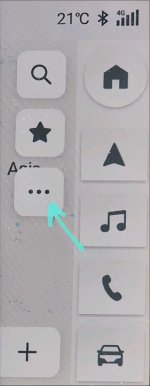

thanks. where in the menu i can disable those?
compressed_image2024-07-15 10_15_45.220130.jpg compressed_image2024-07-15 10_15_45.453095.jpg

That's for the built-in satellite navigation, no phone connected.
I have an XPOWER, I'm not sure which models include the satnav, but if a car doesn't have it then I wouldn't expect these alerts to ever sound for the obvious reason of not having the function.
