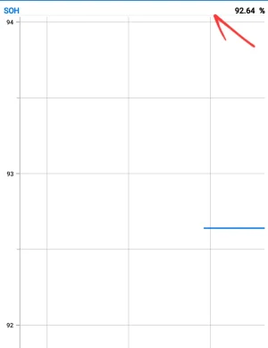

Mine has covered about 15k km in over 2 years. (Low usage). My SOH is about 92.2%, so yes - your appears normal. It would help if you said how long you've had the car/how old it is.
... mine has done the same Km's, and has a similar SOH with CarScanner (its linear with time / distance) - however the dealer says its at 100% - I have a LFP setup at home (ESS), of similar age, and that has much greater stress each day and that is at 98%. I've been keeping a eye on my home ESS and that seems to balance the cells within .01%, but if you dont charge it upto 100% each month, it sort of looses what the max capacity of each battery module is. So on my home system, Ive set it to charge to 100% every month, to reset everything - I suspect the MG4 does something similar
