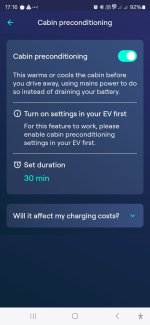

Do you activate any settings in the MG app? If I try to set cabin preconditioning in the Ohme app it states I need to set it in the car first, as per the attached. Thanks!

No I don’t touch anything in the settings of the MG App.
I just press the front window button on the screen and wait for it to report back that the preheating has commenced and will run for 15 minutes.
I am also able to see that the rear tail lights on the car are displaying red in colour when the reheating process is running.
Confirmation that the wall box has reengaged, can be seen in the figures reported on my home energy monitor and the green light charging status on the wall box, and the blue LED’s in the charging port.
Thanks got it. Tomorrow, my Ohme tells me my charging will finish at 0500 so will have to be awake early to try the cabin heating before the charge schedule ends.
