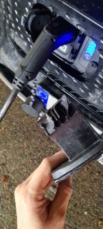

I have just been comparing what looks like the point of failure on your car, to the pictures supplied by @Filtonian above on his car.
Yours appears to have failed, where the hinge attaches to the charge door.
While on @Filtonian car, it appears to have failed at the opposite end of the hinge assembly ?.
The door definitely needs some type of reinforcement adding, to increase the overhaul strength.
Because your has failed close to the flap, is there any way that you could use a plastic bumper repair hot stapler gun, that would add strength to the hinge ( link below ).
When the new part arrives, do you intend to strengthen it, before it is fitted by the dealer.
As the replacement door will only be made to the same standard as the previous failed part.
The price of the part is okay, but the labour is a bit spiteful !.
It could become an expensive repair if carried out once a year !.
I'm actually now a bit worried leaving the car in the public car chargers, knowing how flimsy it is, it is mostly hollow on the hinge part.... and the plastic is not soft/flexible but really hard and brittle , so I can see this becoming a problem.

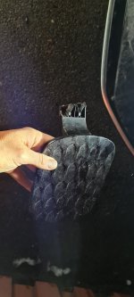

I have been looking at these charge door hinge failures once again and I have now reconsidered my first opinion, that both hinges had broken at two different places.
I was a little confused sorry by the repair lines created, at the other end of the hinge, next to the door itself, by what looks like the use of a hot soldering iron tip.
If so, then it looks like there could be TWO points of failure of the hinge then ?
One behind the bumper cover and one at the charging door flap itself.
I have noticed, that when the door is in the fully open position and on charge, the door flap is at an angle of about 90 degrees to the bumper cover, which is in a precarious / vulnerable position but more importantly, the hinge is really hard back on stop in maximum travel position.
A wider opening door would help ?.
Both the type 2 cable and the charging gun, has little spare redundancy in clearance or travel.
Even less, if you are using a heavy CCS gun from a D/C rapid charger, that's for sure.
The almost over extended door just gives me the opinion, that if any additional pressure / load was placed BACKWARDS or from above against that hinge, by either somebody brushing past it, or the heavy cable / gun hitting it while plugging in, or when removing the heavy gun after a charge.
ANY small additional load placed on that hinge, would effectively result in a failure condition.
A bit like over extending the spline on a brand new hard backed book.
You open it to a point, then if pushed a little more, "crack" the spine breaks.
It does look more like BOTH of these hinges have failed at very similar points, if not in the identical place !.
In the great shot taken by @Filtonian .
If you zoom in close, you can see what looks like a lot of honey comb air bubbles, that have formed in the plastic moulding process.
These HAVE to be a potential weak spot in the hinge.
The door has very little to do in real terms !.
Slight push to pop it open, then very little effort involved in hinging the door to it's fully open point.
Although the design may appear a little weak, with what little is expected from it, you would expect it to last a life time really !.
It's not super stiff at the hinge, where it takes a LOT of effort or strength to open it ?.
However, it will not have be designed to take any additional load as mentioned above, that's for sure.
There could be a real opportunity here folks, for somebody with a 3D printer, to print up a solid plastic hinge to replace the honey comb design on the OEM equipment ?.
Had pretty much the same issue - snapped my 2 months old car charger flat off. Latest quote is £350, the actual part is £35+ VAT. the rest is the labour to take bumper off and put it on again :(

We know the reverse side of this hinge on the charge flap, has a large criss-cross honey comb type design / construction.
The poor design and inadequate lack of strength in this location, appears to be weakest point and is the common failure point.
I am fairly sure if the hinge was made of solid plastic ( delete the honey comb design ) it would be very unlikely to fail in the future, as it does now.
Question :- Could this hinge be therefore reproduced on a 3D printer, but deleting the honey comb design on the rear, and produce it in a solid plastic format ??.
I have no experience of 3D printers, so I have no idea if this is even possible folks ?.
I am sure somebody will be able to provide some better knowledge in this field.
If successful, there could be an avenue for a nice little earner maybe ??.
