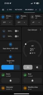

Have you ever looked into the home assistant integration? I do wonder if they expose it in that but not in their app.
This is an odd one. Suggest you ask on the Myenergi forum. They’re very helpful and quick to respond
I have an SE SR and a Zappi and it never once has allowed the charge to continue beyond the scheduled time, regardless as to how much charge the battery has.
That's true. They've helped me a couple of times. Also, I had to call their helpline once, and the guy was really good.
I haven't looked at that at all. I'm trying not to get into it in that sort of depth.
Yea my nerdy brain went down the rabbit hole now control it all via the home assistant app instead of the iSmart. The target SOC is what I have set to 80 or 100 for full. Really sucks they stopped the SE doing it
