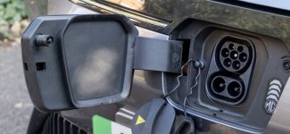

Stopped at a charger earlier, opened charge flap and the pin that holds it locked just fell on floor. It doesn't obviously look like it's snapped but if I push it back in it will click down and hold but doesn't rotate so assume it won't lock and if I press it in again it just falls out. Am on holiday in France so don't fancy closing door with it in incase can't open it again. Door seems to stay shut without it but obviously won't lock. Anyone had similar?

So when the flap is open, is the pin(bit that fell off mine) in the flap or fixed next to the charge point , I can't remember and assumed it was fixed into charge point, maybe I've got it wrong way round and it needs fixing into flap and hasn't actually snapped.
The pin is fitted to the flap. It's within a rubbery sleeve, which slips over the base of the pin. In the picture, you can see it at the top left of the flap. The pin fits into a hole in the flap - it’s a bayonet fitting, so rotate it clockwise until it locks. If the sleeve and pin are still joined, I'd say it hasn't broken.
The 'female' component can be seen in the port, above the charge progress lights.
It's quite possible that the pin had come out of the flap That was the case for mine; I didn't know it was removable until it fell to the ground. Like you, I thought it was broken until I played about and figured it out.

Thanks for that, when it fell out I was rushing to get a quick charge in on way to car Ferry back from France with 2 kids in the back winding each other up(!) so didn't really look at it much at the time, but that photo has helped. I was thinking it was fixed the side hence thinking it had snapped, makes more sense the other way and ill see if I can get it refitted in daylight. Thank you!

Looking at your picture of the pin, I can see what (from memory) looks like the bayonet fitting a the bottom of the sleeve. I'm pretty certain that if you try fitting it to the cover once again, it should fit. Push it n and turn it.
But the important thing is that you don't need the pin to be in place. The charge flap is, as you found, spring loaded to stay closed. I'd say to enjoy being in France. If you want it refitted, and can't do it yourself, or if it IS broken, have it seen to when you get home.
Thanks for that, when it fell out I was rushing to get a quick charge in on way to car Ferry back from France with 2 kids in the back winding each other up(!) so didn't really look at it much at the time, but that photo has helped.i didn't want to try refitting incase it got the flap stuck but I was thinking it was fixed the charger side hence thinking it had snapped, makes more sense the other way and ill see if I can get it refitted in daylight.
