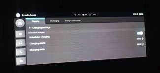

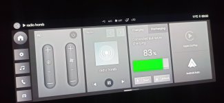

Hello, I've just got my car today an MG 4 SE and it was at 83% and tried to use my granny charger but even though it connects to the car, the charging won't start. I've had another electric car for 3 years but I never had this problem before. I am using a Taysla charger gun. What I am doing wrong? See some pictures. Thank you!

Have you a schedule set up? Looks like there is, and if so, it won’t start until the set start time
I tried with scheduled set up or without in the scheduled frame time. It won't start charging it connects to the car, the led is blue and that's all.
Hi, my car is second hand, it has 14.5 km on it. Do you have any idea if this can be related to a HV battery shut off? What does it mean? Thanks.
By the way, I did turn off the scheduled planning but it still doesn't charge. It connects to the car but won't charge the car.
