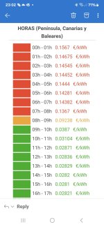

I elected against this after reading of other's woes. The next day's electricity prices are published at 21:00 every night so I just either set the car to charge via the app between 0:05 and 06:00 (when the water heating comes on) if it's cheap then - or for later / not if it's a different price like tomorrow will be:
