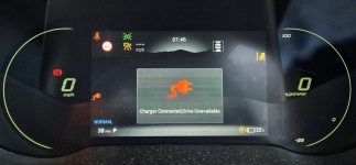

Photo 1 shows the bad sequence; the schedule was due to start at midnight. The first 2 entries are good but "Restarting" and "Charge Delayed" are not normal. Photo 2 shows the car showing cable is connected.

On the occasion it failed, it looks to me like the Zappi threw a wobbly and rebooted when it was told to charge, then for some reason came up with this "Charge delayed" error message when it started again.

Looking at the logs you can see that at midnight the Zappi was instructed to charge, it started communicating with the car but then decided to reboot instead of charging, then wouldn't charge after it restarted. This shows the issue is either a blip in the Zappi, or an issue between the Zappi and the car. Octopus clearly did its bit. Anyway, I'll see how it goes in the next couple of weeks and if it happens again.

when you plug the charger into the car and lock the car, you see blue lights lit on the car charging indicator? if yes, it's the charger not starting when it's supposed to start.
I see two starting times on octopus 23:30 and 00:00 - check if that's the problem. What happens at 23:30? That works?
Set it only from 00:00 and see what happens.
