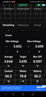

Hi Watchdog, on the free app, I don't get charged, discharged and usage figures. Please confirm what steps can I do to fix it?
