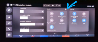

I got the same issue after dealer installed R63 but without updating MCU FICM. To fix iSMART and Weather issues, I reset infotainment but after startup, screen stay gray and I couldn't do anything.
I use shorcut access (swipe down from left or right) and use the setting icon to perform a new reset from engeneering menu. It fixed everything for me
I’ve tried swiping down from the screen I posted and other than the middle to bring up the AC it did nothing. Fingers crossed the dealer can sort it quick tomorrow, and then I’ll start asking questions about the engineering menus ;-)
So you don't have this screen with the tiny "settings" button?
When mine was stuck in startup like you, it was the only way to access Settings to perform a factory reset

OK, tried it again after powering the car off and on and resigning in…again, and a swipe down from the edge does get me the shortcuts screen and has a setting button.
But a factory reset is what got me here in the first place…I guess it can’t make it worse to do it again?!?
OK, so did another factory reset, same issue did the binding thing to the smart app, same problem that I have the iSMART screen, and now know that I can get to the shortcuts and settings, but still nothing else.
However I realised when I unbound the car it skipped the activation screen so I pressed and held the home button to restart the console, did the welcome, set languages and activations, and then when it got to the bone screen I noticed there was a skip button. Well, the car’s already bound so I pressed skip…and I got another screen I’d not seen before asking me to confirm a couple of other settings, and once I did that the Infotainment system appeared!
So…the fix was to skip the binding screen so that I could complete the startup settings?!?
