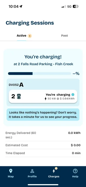

I’m having the same issue in Australia with our MG Zs Lr 23. It can trickle charge. When it plugs in to the fast charger it initially connects and says you’re charging but then disconnects. Have tried
  • multiple chargers also 350 and 50
  • disconnecting the 12v battery
  • holding the plug securely
Any updates on a cause. Interestingly, it did work perfectly a month ago on the fast charger and there’s been no changes since that I’m aware of.
