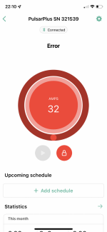

As above, not if you are willing to accept potential throttling. Don't forget that you may also just be deferring the inevitable - now with 2 EVs, battery storage and a small ASHP we sometimes hit the 100 Amp limit of the main fuse on our property.
How do you tell?
