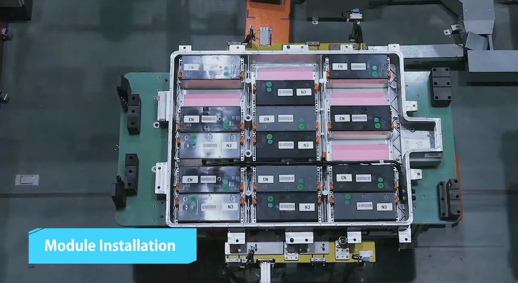

Look what I found on a Thai website:
Our battery is 50 Kwh but the software is limiting the state of charge (SOC) to 90% and this is making our battery 44,5 Kwh usable.
I never read this before and even the MG website don’t talk about this, strange because this is giving the car more value!
If this is true I am really happy because this would increase the amount of charge cycli very much and maybe I can forget charging to 80%?
Google translated Thai to English
But if to let me guess about the battery price of the MG ZS EV, I would like to take an example of a chevy bolt battery to compare it. The chevy bolt has a battery of about 60 kWh or 288 cells. The Bolt is at $ 15,000 or 450,000 baht, while the MG ZS EV has a battery of 50 kWh, but can be used only 44.5 kWh because the software lock can not use more than 90% SoC (State of Charge), so I look. That the battery cost of MG is likely to be cheaper than 400,000 baht per pack (excluding tax for some countries) And if you think about it in a straightforward way, one module will drop approximately 25,000 baht (this is a fun calculation. From the world battery price Which is expected that in the future in the next 8 years, the battery price will be 1 times cheaper than before
That would contradict Tesla Bjorn's assertation that 42.5kWh is the maximum usable capacity of the battery. Given the testing he has done on nurmerous EVs and the explanation he gives about a minute into this video (from 12 mins in) as to why it is 42.5kWh, I'd believe his maths on this.
It is really difficult to analize the real truth.
It could be that this 2 Kwh difference is for the bottom protection buffer.

Well now you do not have to worry too much. Also the manufacturers have been spending loads of money on studying charging behaviour and have noted that the average EV user is more like @Frank than yourself. So that has been factored in when designing the BMS to achieve best protection for each battery capacity.
I will not be surprised if this is true but I must say I have not seen it in any MG data specifications so one will have to check.
I really did not seen anything about this either in any specifications.
I really hope it is true, then we can all do the same as Frank.
This article is really making my day:ROFLMAO:
@Johnberg51,
Tried the translation software and read it in the English translation. To my surprise the author of the article seems to suggest the material in the article came from MG in England.
So I am a bit confused because I have not come across it before in any of the ZS EV English language manuals or advertising materials.
I am not sure if this 50kWh capacity is true. Please update with any information you receive from Thailand.
