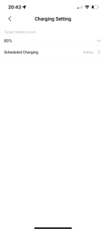

I note that the app is showing battery percentage again but still glitchy. I'm currently at 65% which shows 136 miles range on the home screen. Click through to the battery page and it shows the same and that it is in long-trip mode. But use the back button and it shows 84 miles range or sometimes just two dashes. Refresh home and the 136 range comes back. The option to change the max charge on iSmart seems not be available now either (or if it is, you need to start a charge and I don't want to do that right now as I have set a top-up OI schedule for the first time).

To change the max charge you have to click on the cog in the top right corner
