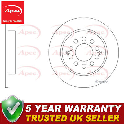

The dealership is not willing to give the OE number they are suggesting for my car, but when I check Alec, Borg&Beck and etc they don't have any rear disc breaks for the EV version, only the Petrol version, do you know if there is any difference on these two OE numbers, one seems to be the Petrol version and the other the EV?
Petrol 10266049
EV 10436735
Ebay seems to indicate I can use the petrol version, for example this link;
Thanks in advance!
Don’t know if this helps, but Autodoc generally stock parts for any vehicle and have always been a go to for hard to find parts with my previous vehicles. They only list front discs, but they do list both front and rear pads. The front discs don’t cross reference to any other vehicle, and no listing for rear discs makes me think there isn’t a substitute part for them either so it’s a main dealer only. I doubt the petrol ones will be compatible as EVs are generally heavier and take a bit more stopping. Seems odd that your rear discs have worn out before the front ones.
