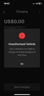

I tried to use Tesla supercharges at Trentham using Tesla app and failed as “Unauthorised vehicle” despite an MG4 alongside succeeding.
I have since paid £140 for a “non warranty “ software upgrade to enable this at MG Derby.
Disappointingly I was still unable to succeed this evening on Derbion Superchargers.
Questions:

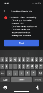

1. Does the Tesla App need to recognise my vehicle as it will not accept the VIN “unable to claim ownership “ .see photo
2. Is it simply that the software upgrade was incorrect or incomplete? See photo
3. Is it simply that the incorrect charger was used this evening? Photo attached

The charging on Tesla superchargers is probably the most seamless of any charger.
So, no, they haven't done it properly.
They need to test the things they are fixing.
Take it back.
That last screen asking for VIN - I don't remember having that question asked on Tesla app ... I don't think it asked me for anything about the car; I just checked my Tesla app and there is nothing about what car I use ...
Have you tried another Tesla charger or have you tried connecting the cable few times? Last time I charged I had to fiddle around with app taking longer than normal - guess it was poor signal area on my phone so in your case could be anything, not only the car ... Try again on one or two other Tesla chargers but also call your dealer and say upgrade doesn't work, ask to be fixed since you paid already

I have spoken with Tesla and you do not need to add vehicle to app to use it. Everything is in place on my Tesla account and app and the chargers I have tried are working and compatible.
So back to Stoneacre MG Derby to get this resolved as appears to be the software upgrade that isn’t working.

what did they say about the last screen asking for VIN or lease car? If the app was saying that's the problem, it may not be the car ... (unless you clicked you have Tesla car? - check the app settings once again)
But yes, best to take it back to your dealer to double check. You could ask them to pop around to nearest Tesla with them and demonstrate ...
It isn't the chargers. They are pretty much plug and play. As soon as you select the post number on the app, with it plugged in, the connection is established within a minute in my experience across multiple Tesla superchargers across the UK and France. It should be seamless.
Taking it back to the dealer is the right move.

Sounds like the s/ware update didn’t run properly as the Tesla app/charger conversation doesn’t require a VIN for non-Teslas …

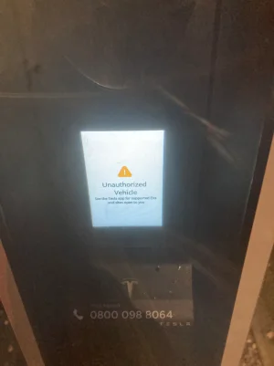

Did it say unauthorised vehicle ‘ while you were waiting for it to work? I connected and it just says ‘unauthorised vehicle’ and nothing else.

Yes checked on the Tesla app. M5 Frankley services southbound. Activated charging on the app. It dithered for 30 seconds or so then showed ‘unathorised vehicle’ in the screen. They have only recently been installed so they must be the newer style chargers .
Does anyone have any details on the actual software version needed to charge at Tesla public superchargers? I regularly charge my MG4 at Frankley South Services with no issues at all, works like a dream. Having recently also bought an MG ZS, I also got the “unauthorised vehicle” message. I contacted MG customer services who checked my VIN and said I had the latest software installed and the issue was with Tesla not opening their network to the latest MG models. Seems odd as have used many other CCS chargers with no issues. Also seems strange that other ZS users here seem able to charge?
Might be worth trying another charger or trying another location to see if it's the car or the charger. Some ZSs needed that Tesla fix... if the car is new, they should fix it
