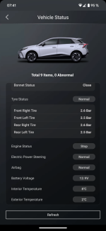

I have had my MG4 for three days now. I am sitting in my car exploring the software. I cannot drive right now because of the snow, and my car has summer tires.
It's 2 degrees outside and 8 inside, and the car won't heat up the cabin like it did yesterday. I have tried the tricks mentioned here, but still no heating. Maybe someone here can tell me what is wrong?
The car is not plugged in.

I notice the Air Volume In Auto Mode is set to low. If that is increased to medium or high does that improve things?
No. And the amount of air doesn't change either.
If I let it run for a while on auto the air volume changes from low to full blast without any temperature change.
Lock the car, go away with the key and return after 10 or better 15 minutes. It will usually work then. I have this issue every week.
