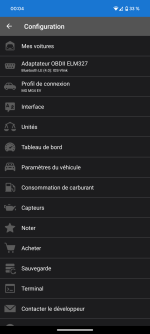

Can you tell me yours settings in CarScanner please ? It never work with my MG4, NMC battery...
Go to settings-> Connection profile-> MG -> MG4 (its marked as experimental profile)
It should work with ELM327. If it's work for you please post your SOH ?
It's already set
But I don't have the last update on my OBD Adapter so I'll try that.
Thanks

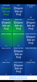

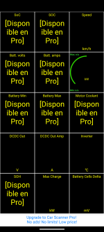

I try again yesterday. Doesn't work. So I bought pro version, I'll try later and let you know

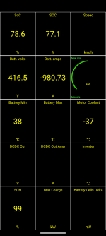

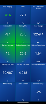

So, What I get now.
SOC in car 83%, SoC Display 78,6% and SOC 77,1%
I'm so confused...
Car Scanner said my SOH is 99%, dealer 97,5% during the first service 1 month ago...

The soc difference is also at mine. I don't know why. But looks like the SOH in the scanner is correct.
I verified it by resetting the trip data. After you reset the main trip data the GOM (estimated kilometers) should go back to WLTP data minus the degradation %. (At normal mode, with no A/C.
That's mean that if the WLTP range is 435KM, at the GOM at full charge you should get 430-431km (or 356km at 83%). (You can check on the charging limit scroll after reset) i am getting 426KM which is 435 - 2%, but half the mileage of yours.
