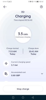

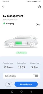

Initially, when using the Type 2 cable that came with the car, it would only charge at 3.7kW (claimed on Monta app) / ~3.3kW (MG iSmart app.)
"Must be a 1-phase 16A cable" I thought.

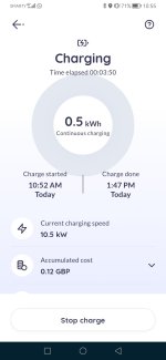

I borrow his cable and test it on both charging points.
Immediately charging at near 11kW (Monta) / ~9.7kW (iSmart) at both points, which is to be expected when accounting for losses / car limitations.
Happy days, the car will take 11kW as suspected (from what I can tell this requires either a 16A 3-phase or 32A 3-phase cable such as the Tesla one used?)

I carry on using the provided cable and continue charging at a painfully slow 3.3kW.

It's always on AC current as per attachments - flicking between 16A & AC current has no effect on speed, it stays around 3.3kW.
