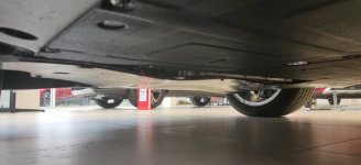

Went into the dealer I have ordered my car from today, as they finally had a trophy to look at in the flesh, I was raising some concerns about the issues everyone is experiencing. Salesman told me they haven't had any cars with oil leaks or tray bulges. He wasn't happy when I told him to look under the 2 cars they had sitting (both with bulges!!)
Doesn't really fill me full off confidence that they haven't even looked at the dealership cars.
