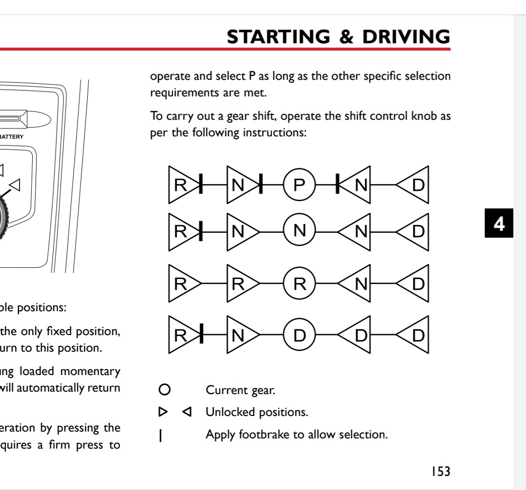

If we trust MG for the information in the user manual, R cannot be selected from D position without applying footbrake. So they built in an element of safety.
In the following page, there is a statement on P. The same can be used below 1mph. We do not know if this is a safety advice or P will be denied by the computer above 1mph.
Yeh Leo I have seen that so if it can’t be selected why are they saying you must not select it
Not sure but I would think pressing the selector (P) whilst moving would throw it into N unless you're just rolling slowly where it will apply the parking brake.
It does not say vehicle should be at standstill.
So if someone were to coast on neutral, apply footbrake, slow down and accidentally switch to R without taking foot of footbrake !!
Coasting on N is a bad idea. From D, this scenario seems highly unlikely.
I think it is worth clarifying with MG!!
