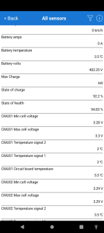

together with the "Car Scanner" App:
Do you leave this dongle in all the time. I fitted one today and used this app. I couldn't find battery state of health values on it. There was an empty square on a page that was titled as such but no value was showing. Then the cars alarm kept activating after I had put it in so I had to take it out again.
I have just put the same blue device in and got this on my MG5

Have you tried the car scanner app?
Works great on mine, the outside temp window shows 218c but i can live with that.
When is on charge it shows a negative reading rather than a positive reading but i can live with that.
