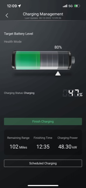

So I had it in my head that the car needed to be on. This also explained why 3 attempts I made to rapid charged failed yesterday.
After reading here and then the manual I tried using the rapid charger the right way lol and guess what it worked. InstaVolt for reference.
I got 48 up to 80% then dropped to 34 after 80%. I was happy with that. I only charged over 80 to see what the charge wait would drop too.
The only thing I noticed now is after every changée the car flashes up ACC system unavailable but then goes by the time the car has finished booting. I am going to ask the dealer about this.
