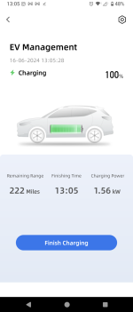

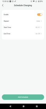

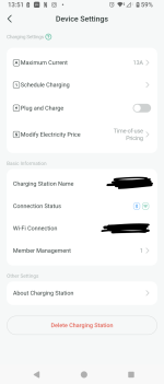

p s. on my £120 3-pin charger, I can setup schedule for charging as well as few other bits and you can also use MG iSmart app to start and stop charging if your MG model supports that app
