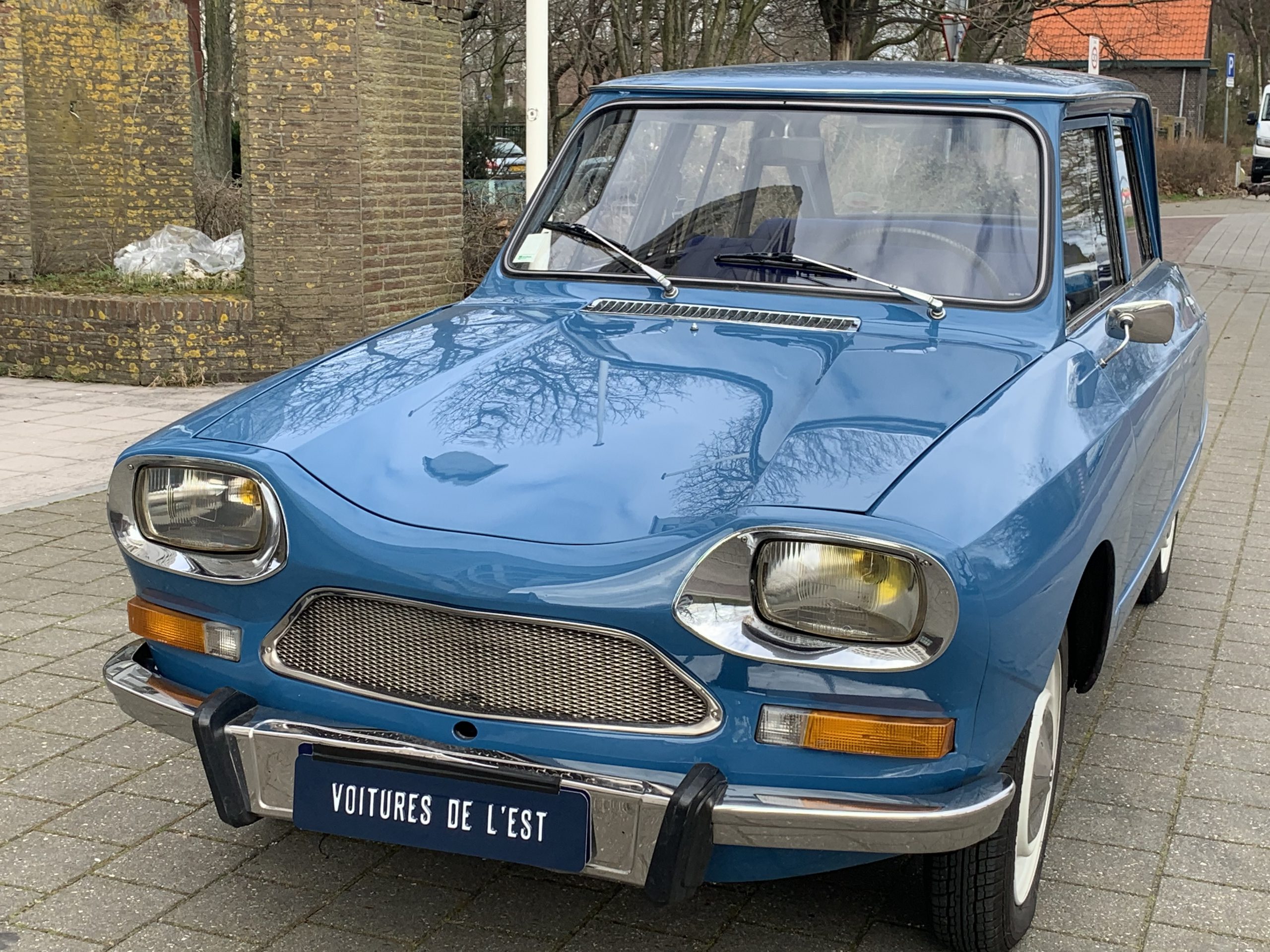

I almost thought you were joking...as this is the Ami I know...
