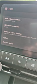

So due to an issue i was having where my rear offside tyre was always reporting low pressure, I booked it in and took in on 4th of August, I had to wait until the next day to collect due to some Internet issues at the dealership.
Ever since I collected the car LKA is now no longer staying off, nearly had a crash for me to realise this is the case.
Here is my current version my previous version is in the quoted text. Anyone knows if this is reversible?
No it's not. If you find you can't live with it you will either have to get into the habit of turning it off every time you get into the car or if it's really aggressive ask the dealer to recalibrate the camera.
