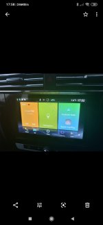

If my ZS EV can tell me to be careful as there might be icy roads why can't it display the outside temperature?
Had the comfort 2 update but not there!! Would someone be kind enough to taker a picture so I can show the local garage who won't believe me
Picture as requested of outside temperature. Hope this helps.

For me also it's NOT showing temperature but it showing range in instrument pack ..
I am confused whether I have got this update installed or not !
It is not installed properly, this is from the MG website:

Which includes vehicle temperature in the display. Return to your dealer and have them do the updates properly.

Dr Dave is correct, if you don't have ALL of the items on the list in his post, then the "Comfort 2" update is incomplete and needs reapplying.
Hi, you need the software update, it also shows on the dash milage left and a few other bits, quicker startup with less bing bongs. Most got the update free but speak to the dealer about the v2 software.
