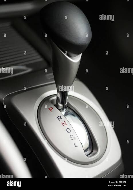

The little button is like the handbrake lever you would have had in older/other cars;
The dial with RND is like an automatic lever;
