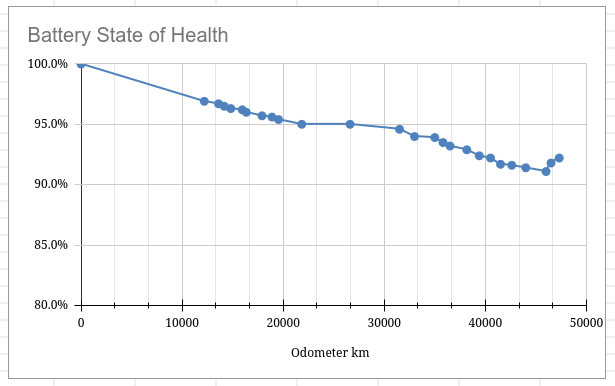

I've been monitoring the SoH on my ZS since 11,000km. The graph looks like this:
Note the interesting up-tick at about 46,000km. Any ideas on why this might be happening?

interesting up-tick at about 46,000km. Any ideas why this might be happening?
I don't notice that in your graph. But I think that up-ticks happen when the BMS stops guessing a fixed degradation per time, and completes an actual calculation. It may have to wait for the right conditions, e.g. the battery was recently discharged low enough.
Hmm, I think there's a caching problem with the MGEVS server - click on the graph to see the correct version. You may be right about the discharge - I recently got very low on charge.
Huh, that's weird. I tried editing the post, but no change.
A two data point up-tick is less expected than the occasional single point up-tick. Perhaps there was a single large correction upwards, and there is some sort of smoothing going on. Or maybe these two up-ticks are largely temperature related. Things have gotten a lot hotter fairly quickly down under, at least in my area (south east Queensland).
I just re-named the file and changed the link target and the graph now works.
I'm in Sydney, and the weather hasn't been that unusual. I don't think it's that.
I think it must be related to a reset as a result of draining the battery down to a low value. I recently got it below 10%, which is unusual for me.
