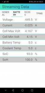

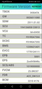

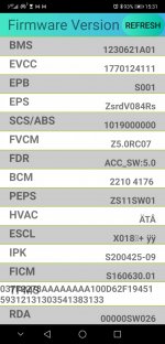

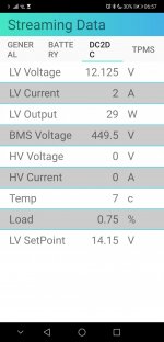

Hi, please find data with 100% charge and equalisaion. Bought car end of December 2020, driven 515 miles, got BMS update on 25th January. Never done rapid charging, all with fast chrager i.e. 7KWH except equalisation on granny charger. 449V on display with 100% charge , HAVC off Economy range 200 miles. HAV off Normal range 182. App data SoC 93%, SoH is 100% with Voltage 449.5 V

I've added that into the main spreadsheet, and into my new little data at full charge spreadsheet - I'll update that wherever it was I posted it!
Did you reset the Accumulated Trip before you recorded that GOM in N3 reading? (As I'm surprised it's not very close to 163miles)

Thanks. Last time GOM was reset on 25/01/2021 when BMS was updated. I will reset next time when charge 100%
Does anyone know what the SCU is, my version I think is different to some others.
