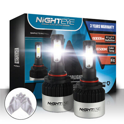

My Nighteye LED Headlamp bulbs arrived yesterday and look great.

Read the entire thread but still have a couple questions. The headlights on my ZS is quote poor compared with my other cars. Sometimes it seems not any brighter than street light with the headlights on. What is the best bulb to get and where do you go to get it? Halfords? Cheers in advance.
Not too bothered with signals and reverse lights as i cannot see those. ;)
Get the night eyes off eBay there are links on this thread, you’ll be surprised how much better they are for about £18
Anyone fitted one of these in their car and any chance of a pic? The ebay site says the bulb is not compatible for the MG ZS EV. :(
If you're talking about the Nighteyes, they do fit, I have them fitted and they're great. No pictures though.
