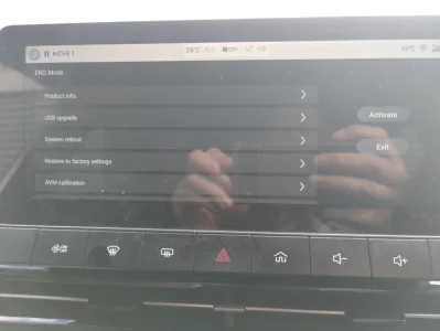

200519 is the pin for mg4 could be the same but for some reason I can't find where to put it the 5 taps don't appear to be working?
200519 worked for me!

In the menu where you can see the what version the infotainment is running, if you press the version string 5 times, it pops up a dialog, asking for a pincode.
I wonder what's behind that pincode. The secret menu perhaps :)
Must enter 6 digits before the "OK" button becomes active so quite a lot of possibilities :)
From the original post it states "version the infotainment is running, if you press the version string 5 times,", this does not work on my 2023 ZS EV

Go to the dial pad and type
##4479#*
This will open the menu, however I have been unable to find a password to enter the in depth engineering mode from here. To access the engineering mode password prompt, tap in the bottom right hand corner of the screen 5 times. To my knowledge the password isn’t known to progress any further and if you have a valid warranty, it wouldn’t be wise to do so.

I think you are talking about the older 9" screen, mine is the 10.1" flat screen and does not have a dial pad :unsure:
Definitely the 10.1” screen, without going out to the car, to get to the dial pad the process was Telephone icon > Keypad icon (on the right). I think on my first attempt I connected my phone via Bluetooth because it made accessing the dial pad easier. If you don’t have any luck, let me know and I’ll attach a video to this thread tomorrow! My car is also a 2023 ZS EV so shouldn’t be any material differences hopefully
For reference, phone icon on the bottom then keypad on the right. This is on the UK model so I’m unsure if this is the same in the AU version.
Ah, the penny finally drops. I thought you were referring to the round knob below the screen on the 9" HU :rolleyes:
