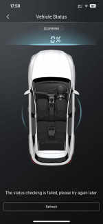

I think the problem occurs in all the around the world MG car.
I used MG HS I-Smart Petrol (not PHEV)
The I-smart app couldn’t connect after i leave the car parked 2 hours, but if i open or unlock the car door, it can connect again.
And then after i leave the car again around 2 hours, it couldn’t connect the app again until i unlock the car.
I have this issues since this Saturday. I live in Indonesia and the weather is not snow.
