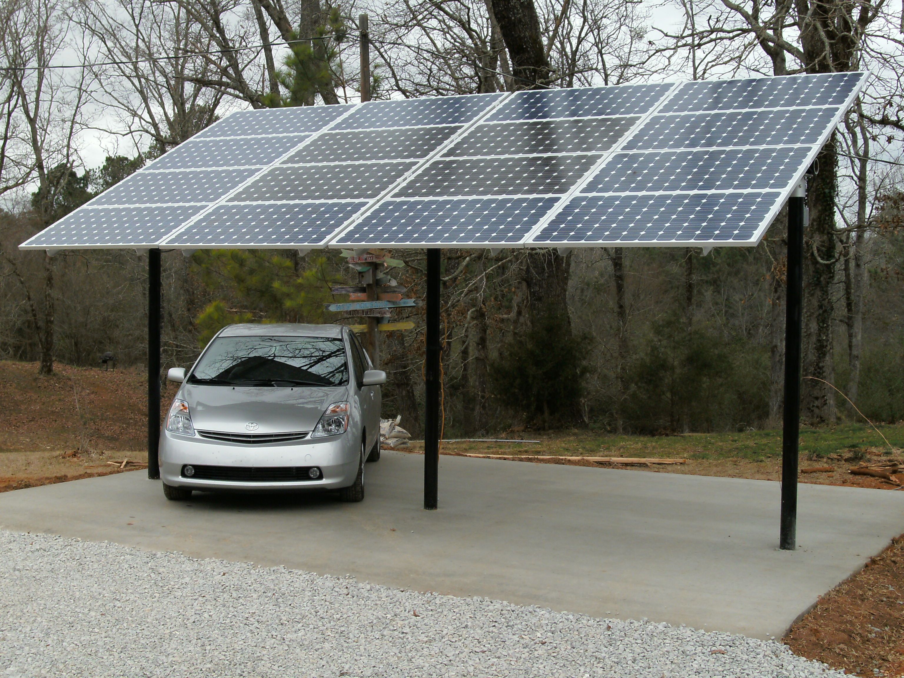

There are car ports with solar panels/solar panels used as a car port. I assume there is an inverter connected somewhere but not sure whether these are viable/available yet in the UK. Integrated battery storage and an EV charger would complete the ideal configuration no doubt for a complete off-grid set-up. Alternatively, if you have panels already installed, this might be an option to supplement the generation capacity of your existing PV array.
I have also seen pictures of something similar attached to the back of the house, to provide a semi-shady pergola. I think they look better than covering your roof with panels for home battery storage, and would also be easier to clean/clear snow from etc.
