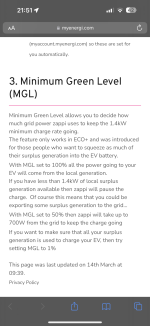

Hi @RichDragon ,
Not sure if you’re aware, but there is a setting on the Zappi 2, Minimum Green Level, whereby you can use virtually no grid power at all, see my attachment.
Apologies if you already knew this. Just started using the Zappi this week after getting my car recently and am trying to find the very best way to use my solar and battery, and came across this bit of information.

Hi @RichDragon ,
thank you JDMB for that information, since my Tesla battery was connected I use zero grid power which is a REALLY wonderful feeling. I had the installers out a couple of times and they had no idea how to reduce the 1.4 setting to use less grid. I have no need to change any settings now and whilst I thought I'd gone through every option on the Zappi2 it might benefit others if you could print the MGL, Minimum Green Level, setting and how to find it.
Much appreciated, it's so much easier to find out how to do something on this site than try to wade through the hundreds of digital pages of the official MG Manuals.

Hi @RichDragon ,
Am really pleased this was of some help to you.
There is a really good explanation of it from MyEnergi’s Dr Chris here , but the documentation is, as you’ve found, not great.
It is mentioned in the user guide Here , but again the instructions aren’t great, but the post from Dr Chris explains it better.
The key thing here is that it has to be set in the app but is only available using the Eco++ setting, at which the slider for the MGL is then visible.
