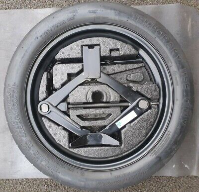

Havent received my car yet but planning to add a space saver wheel, can the floor still be fitted in the lower and upper positions with the spare underneath ?
If you are using a "Space Saver" wheel kit, then YES !.
You can use the boot floor cover in any location.
If you go for a "Full Size" spare wheel and tyre, then NO !.
You will loose the lower function because of the increased high of the full size wheel.
I have the "Space Saver" kit because I wanted to retain the larger boot space.
I coil my Type 2 public charging cable around the outside of the spare wheel.
Not a big fan of having charging cables on show in the boot, it kicks in my OCD :ROFLMAO: .
Exactly the answer i was looking for, thanks !
You are very welcome !.
The MG space saver kit I bought when my first Gen ZS EV was fairly new, only cost me about £145 if I remember correctly.
This quickly increased in price to a whooping £250 !!!.
If you make a quick search on the forum, you will see that some owners have purchased VW space saver wheels ( Golf I think ) and then bought a jack to go with it.
A much more cost effective option.
You will need four VW wheel bolts to go with it, because the angle of the countersink is different than the MG rim.
