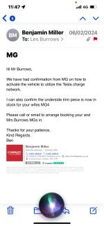

Hi Biffo I was sorting my inboxes this morning and came across this for my dealer from 06/02/24 ignore the bit about the MG4 in the email screenshot that’s a different matter my MG5 trophy goes in tomorrow to be updated I hope. Also up thread at #522 there is more information show it to your dealer.
