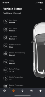

I think 12.7 is normal which is consistent on my year old MG4 SE. The meter isn’t required if you use the MG AP
Yes if after 12 hours of a full charge the voltage of a good new battery could be around 12.7v. Once this figure has reduced to 12.0v basically the battery has had it and will need replacing. Immediately after charging the voltage can up around 13 to 14v and can be watched slowly falling on a meter.
