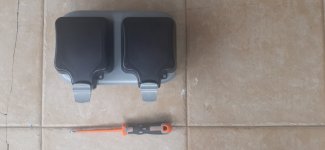

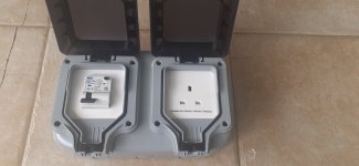

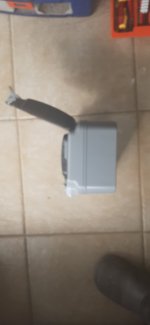

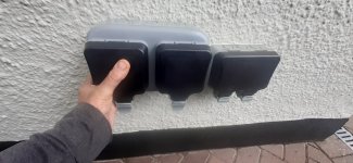

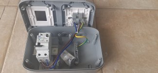

OK I have received and installed the Masterplug EV charging socket from Halfords. It replaced an existing BG (same make actually) Storm double socket under my carport. A bit bulkier but a doddle to fit.
It comes with a 16A type A rcbo which strictly speaking not necessary as I have a similar rcbo fitted but handy if you haven't..
Attached some pics,
Attached some pics,
I like the fact that there's no switch on the socket, always a weak point with sockets and will add to the resistance/warming of it under load.
I don't know if it's a problem which only affects older RCBOs but if you have an RCBO in the garage that is supplied from an RCBO in the consumer unit it can cause issues.
In my case when the consumer unit was replaced with one containing RCBOs, half the house could trip out each time the Off/Test button was pressed in the garage.
I'm wondering if garage devices have a much quicker trip time than the consumer unit ones nowadays?
No they all should be 30mA and trip within 300mS at that level, 50mS for 5x 30mA. Its just random, not dangerous but ad you say could be inconvenient if your whole house is on one RCD.. some installations may have a 100mA delayed action RCD thus preventing it tripping first.
