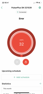

I had a wallbox pulsar plus installed on Thursday. They tested it all and everything checked out. The lights on the unit were green/normal and no errors on the app. The last thing they did was switch on all the circuits at my fuse box. One of these is the PowerPoint that had a BT mini hotspot for my Wi-Fi in that part of the house.
Now I get an error reading on the app and an odd light on the unit itself. Wallbox help pages don’t even list that light as an option.
Will switch off the hotspot tomorrow morning and see if that works.

Hmmm presume the wallbox communicates via WiFi?
And the hotspot is a WiFi extender (plugs in to a socket & rebroadcasts a WiFi signal)?
If so suspect some conflict over IP addresses or the wallbox was setup to connect to the router WiFi whose signal is now being "drowned out" by the extender?

I switched off the whole Wi-Fi extender thing and the wallbox display changed to this.

The wallbox app says a red light means “there is an error”. Nothing of any use to try and solve it. For now, I have switched off the EV charger circuit in the fuse box so we can have functioning Wi-Fi. It was running very badly since the charger was installed so I am thinking there is an IP address conflict or similar. Don’t know how to solve that though.

Have now power cycled everything. Power line Wi-Fi is working ok. Wallbox is connected to the internet and I can access it on the app. Still showing red light. I rang support helpline. They could connect to the box and can see there is a broken sensor. They will send a replacement unit.
