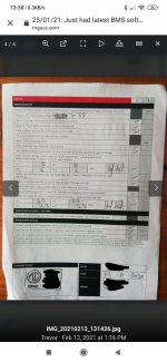

Regarding the updated BMS software, I had a call from Cambridge MG inviting me in for a BMS.
update after MG themselves had advised them based on my VIN number.
They carried this out, while I waited, and when finished, they presented me with a voucher for my next full / annual service to be done FOC.
As a bonus they had left a model of an MGB on my dashboard. Faultless customer care.
