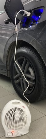

Could u share the link. im looking for a 32 amps V2L plug.
My works properly - tested !

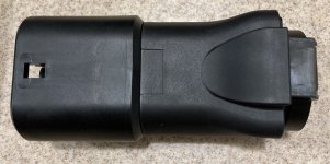

My adapter arrived today. My 2023 MG4 Essence doesn't recognise it when plugged in.
Hi. I also purchased a dodgy V2L adapter on eBay which didn't work on our MG4 Essence 77. The biggest surprise was getting a full refund with free return postage.
We bought another type from a seller in Adelaide, but they refunded the payment 2 days later citing a problem with their stocked item.
Finally I purchased one from AliExpress and as stated, it arrived today after a month long delivery. It was a bit more expensive at AUD $83.19, but it actually works! The shape of the MG4 socket cavity means the adapter's display is slightly obscured, but still readable. There is a little switch just above the outlet plug labelled C-M-K. Select M for the MG.

I bought one of the eBay adaptors. Plugged it in to get a blue light on the adaptor. The charging screen on the MG4 seemed to recognise it, but when I hit 'Start Discharge', I got a message "Discharge failed - discharge cut off power is higher than . . . " etc.
Just found somewhere else that your battery needs to be over 80% - seems odd.
There is a discharge setting in the MG4 where you can choose a cut off % based on how much you need remaining to get to the next charging point. If your setting was at or above the battery's level, that might explain that message. Mine works below 80%, but my bottom limit is currently at 50% (maybe that's the default), so it will stop when it reaches that.
