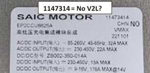

Ps ,the EVCC is mounted on front nearside chassis member below the 12 volt battery if looking in bonnet from front right side low below headlight, near wheel arch.

Anyone had any luck getting the EVCC replaced on a vehicle released after the spec apparently changed. I got a 73 plate ZS EV LR Trophy in Feb 2024 and V2L doesn't work. However the spec I was given at order lists it as a feature.

Yes it is an item that should work , seems some cars were fitted with incorrect unit. please look at my previous issues you will find info about the replacement which should be done under warranty, Mg Bournemouth did mine, very helpful.

Can anyone confirm if 11313413 on a trophy lr registered late sep 22 is compatible with v2l?
