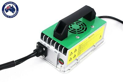

Or could just use a plug in 48 V charger designed for these batteries as well (another quick Google):
Obviously you'd need to choose a charger suitable for your battery chemistry and charge voltage needs.
I prefer the first option as it allows me to set charge voltages I prefer to use (in 0.1 V increments) and the DC charge current is also adjustable (in 10 A increments).
