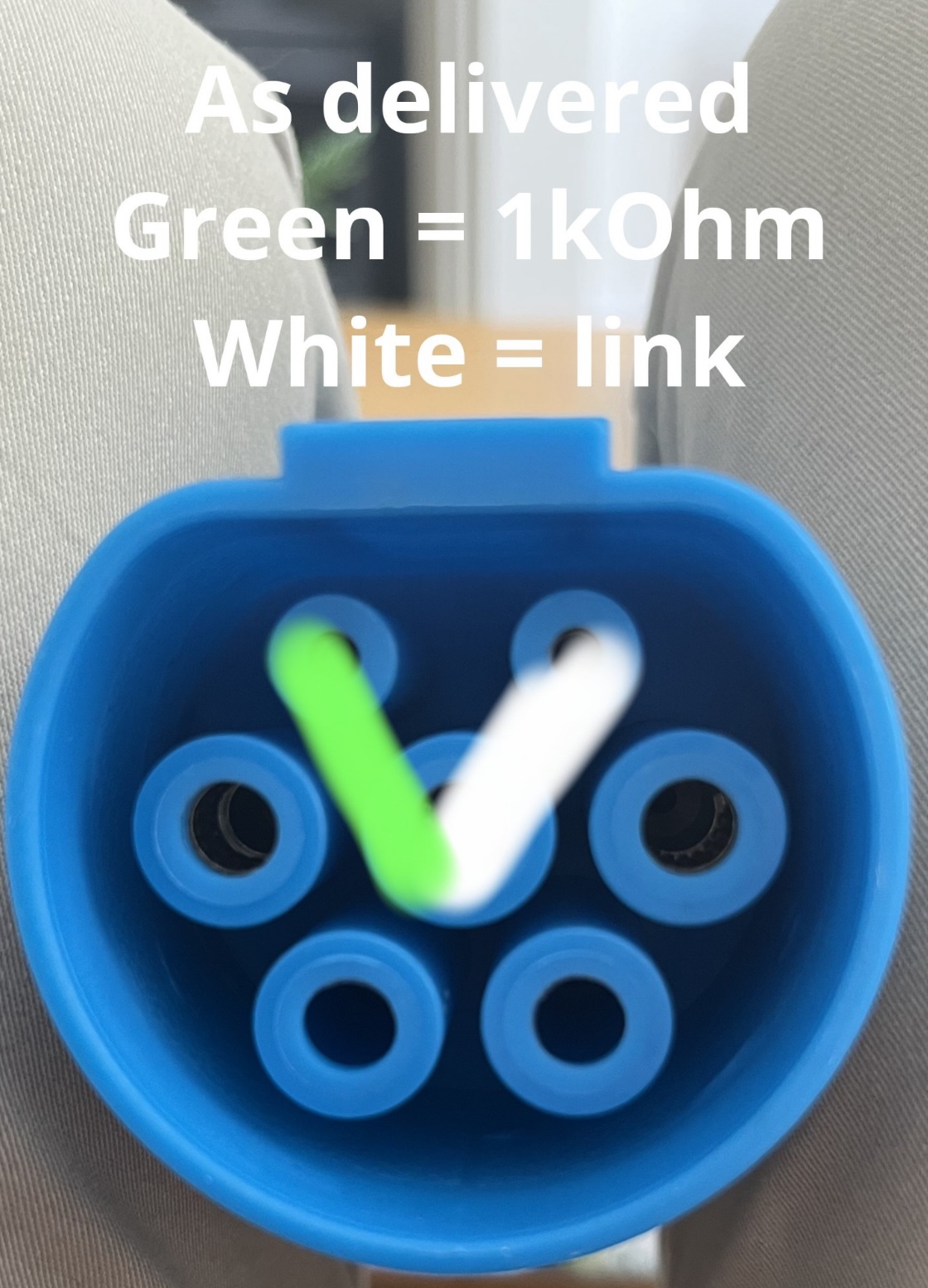

There is no logic whatsoever in the cable, it's all managed by the car. I have already posted the wiring diagram, photos and a shopping list so you can make your own for around about £85.

Or you can make an adapter yourself for cheap (< £20).
I made a post about it.
IMHO, all of these are ok for less than 3kW.
For upper power (6kW seems possible, because unit state 7.2kW at a minimum), you should take great attention about cable gauge.
In fact, an adapter is good for true for real V2L use : have some main power with car, anywhere you are (bbq ... lol).
For more powerful setup, like home grid backup, go to a custom cablery with strong components.
