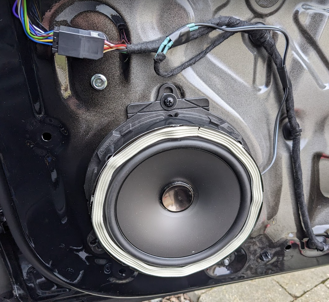

The adapters I bought was a mistake. They could be fitted on top of the adapters supplied with the Pioneers but that made the whole thing to deep. Instead of buying new adapters I took of 15 mm. This should give me perfect height and fit (I will install later today).
Too thick. On polarity: green is negative and should go to the narrow connector on the speaker. Similarly, brown should be negative in AlunJ's previous post.
Cut 15 mm of the Amazon adapter. Connected the two adapters with screws. Added some Tesa foam tape before mounting the speaker. Will install later today.

Added some sound dampening material to the door (20x26 cm).
Speaker installed! It's not pretty but it's all gonna be hidden anyway. The speakers will need some run-in time, but the bass is so much more controlled and natural now. Overall a huge improvement in sound quality. For me, the best EQ-setting is currently Off or Auto. 3D and Virtual Sub must be off.

I used a similar foam tape on the speaker face. Much improved now and I can enjoy my trance tunes again ? Rear speakers will be the next problem with no wiring in place on the SE ?
